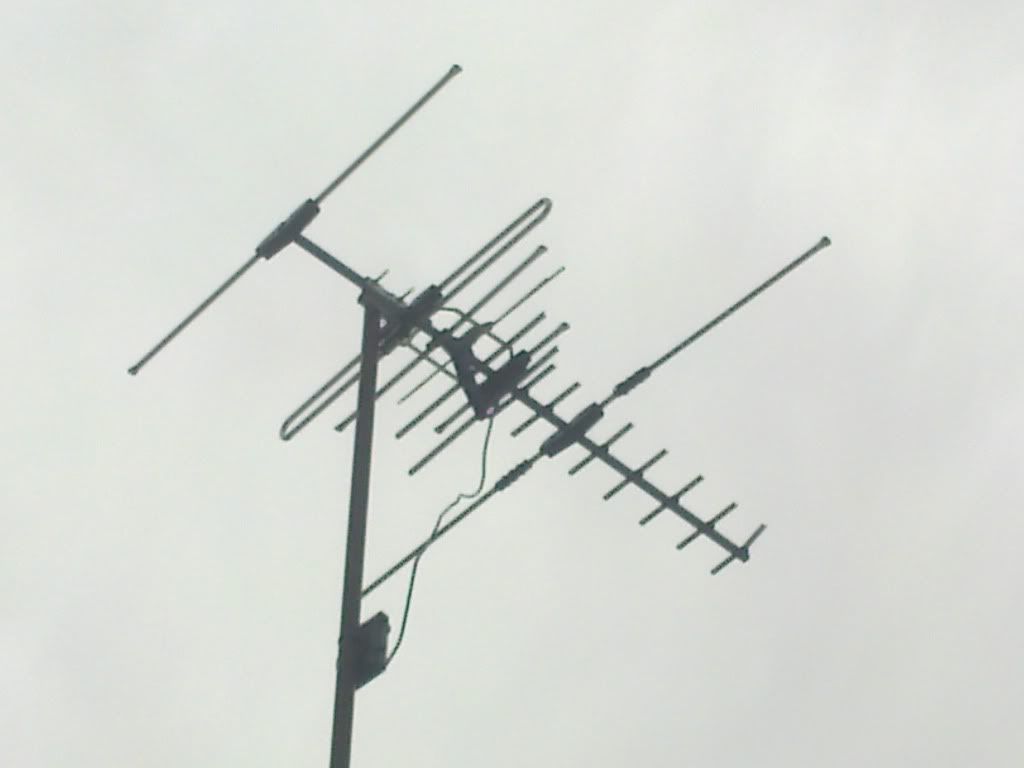

Anyway i have a Kingray power supply,with a power injector,and i hope the picture i try and load of the aerial works.
thanks heaps craig.

That antenna looks like it has either band 1 or 2 elements (the longest ones) as part of it, these are the elements which are most likely to pick up impulse noise interference. If receiving from Upper Namoi, you need an antenna for Band 3 and either band 5 or band 4+ without any band 1 or 2 elements.
You may also potentially be eligible to receive VAST via satellite. This can be checked on the myswitch website.

Posted 20 February 2012 - 06:55 PM
GTS Monaro,
The antenna you are showing is not the right one for Mt Soma.
Since you are not in Tamworth your installation is for Mt Dowe which covers the Upper Namoi and is much more powerful than Mt Soma.
ABC8 NEN9A (Prime) SBS36 NBN37
NRN40
Southern Cross
Channel 8 & 9A are band 3 and the others are band 5.
There are more sensitive band 3 antennas than yours around.
However sometime prior to the end of 2014 these channels will be changed to be either channels 6, 7, 8, 11, 12 (band 3) or all UHF. So I would not spend a lot of money until this is known. If they go UHF your problems will disappear, if they make them all band 3, then you should replace this antenna with a high gain band 3 antenna only and perhaps install a filter between the antenna and the masthead amplifier.
AlanH

The antenna picture you have posted appears to be of a Hills SMX14WB, SMX14B4+ or clone thereof. In a high signal environment (read closer to the transmitter) this antenna would most likely be suitable.
In your situation, you may even need separate VHF & UHF antennas to get optimum reception from Mt Dowe.

Your pro sent you the right type of antenna for Manilla. It may not be sensitive enough, but it is the right type.
You have the right type of antenna pointed at the region's main high powered transmitters. It is just that you do not have quite enough signal to overcome strong impulse interference. You could try an UHF phased array pointed at Mt Soma but there is no real guarantee it will work any better. If Mt Dowe eventually goes all band 3 then a CA16 phased array would remove your problem, however these are large expensive antennas. If they go to all UHF then a high gain UHF phased array would be best.
The transmitters in Armidale are low powered and designed for the town and its surrounds only. Digitalready does not suggest Armidale, only Tamworth.
A Kingray MH-FL3BPF should be set to pass H and U only and inserted between the antenna and the masthead amplifer. This then may allow you to increase the gain of the amplifier if the signal is free of impulse noise. This will then make the signal stronger than any impulse interference picked up in the cabling between the amplifier and the TV.
AlanH

Posted 24 February 2012 - 09:24 PM
Thats a Topline TL14UV Combo Antenna (or something very much like it). It is only Band 3 as far as im aware, the big arm halfway down the body is actually fake, the two plastic covers halfway down the cover a gap, the element only reaches to the plastic covering. Its a pretty average antenna, only good for somewhere with good coverage.
Given the predicted (digitalready.gov.au) signal coverage you will probably need dedicated VHF and UHF antennas. Street view on Google Maps seems to show all High gain UHF and VHF Yagis. Check out what your neighbours have as some parts of town may get better reception from Tamworth, and others from Upper Namoi.
Personally i beleive you just dont have enough signal at the aerial (cant prove this without being there obviously), and that means your amplifier is just amplify the crappy signal its getting (ie. Garbage In = Garbage Out). Oce we have some high gain antennas in, IF there still is problems we can begin to suspect things like CB Radios, Electric Fences, Cordless Phones but Ive personally had little trouble with these things.
PS. Manilla is much greener on Google maps than the last time I drove through (have family in Barraba).
Edited by nbound, 24 February 2012 - 09:44 PM.
#25 alanh
alanh
    DTV Forums Master
  • Senior Member
  • 12,328 posts
Posted 25 February 2012 - 02:22 AM
nbound,
This antenna is about 10 element UHF (count the short elements). Also he is receiving 3 UHF stations with no problems. There is insufficient band 3 gain because of the small number of longer elements.
